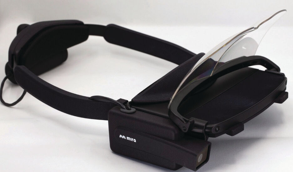

Fictiv 3D-Printed Parts Assembly
Fictiv’s multi-jet fused, 3D-printed parts assembly for Mira Labs, an AR company.

Another common design mistake centers around 3D printing’s scalability and knowing when it’s the right time to consider alternatives such as urethane casting or plastic injection molding. 3D printing end-use parts is a good choice when you want to get working products in the hands of customers, Hall notes, especially if they are still relatively early in the product lifecycle and may still be making design changes.
“This is why multi-jet fusion was an ideal choice for our customer Mira Labs, who wanted to do a small, cost-effective run of products for their augmented-reality headset. But at a certain point, once the design is stable and you’re looking toward scale, urethane casting or injection molding can be a better choice.”

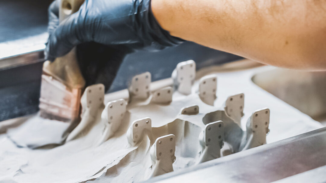

Powder Bed Depowdering
Depowdering is a necessary post-processing step with any powder bed printing technology.

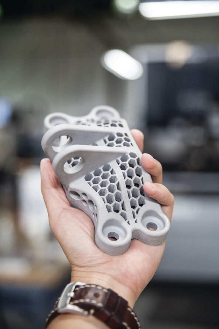

Xometry Metal 3D Print
Metal 3D printing as shown here offers great potential for lightweight product designs.
