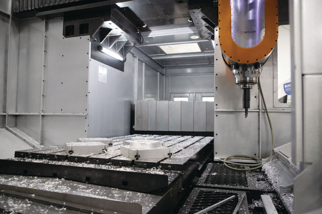

Jointless Hull subsection tool
Like its big brother the hull-scale tool, the Jointless Hull subsection tool shown here can machine parts in the same handling, albeit much smaller ones.
It was around this time last year that we spoke with Nanci Hardwick, CEO of Meld Manufacturing Corp., Christiansburg, Va., who described her company’s metal additive manufacturing (AM) technology as both mesmerizing and “almost magical.” She was most excited about two recent developments—the introduction of 3PO, her latest Star Wars-inspired 3D printer, and the Army’s purchase of two custom Ingersoll Machine Tools hybrid systems that incorporate MELD Additive Friction Stir Deposition (AFSD) technology, one of which has earned the title “world’s largest hybrid metal 3D printer.”
Given the AM industry’s rapid pace of change, Hardwick’s tenure on the “world’s largest” throne will surely be short-lived. Sorry about that, Nancy. In the meantime, though, her colleague Dr. Matt Kelly isn’t concerned with temporary titles and claims of biggest, fastest, or most capable. He’s more interested in putting the AFSD technology to good use.
“The smaller of the two machines, called the Jointless Hull subsection tool, has a build envelope of roughly one cubic meter,” Kelly says. “It’s located at SAE International’s Advanced Manufacturing Commercialization Center (AMCC) in Sterling Heights, Mich. The Jointless Hull hull-scale tool is located at the U.S. Army’s Rock Island Arsenal in Illinois and has a build envelope of 30 x 20 x 12 feet (9 x 6 x 3.7 meters). Like the subsection tool, the hull-scale tool is a hybrid printer with five-axis machining capabilities, however its size makes it a very unique machine and capability.”

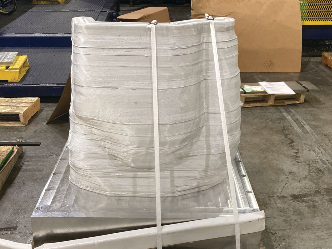

Army Vehicle Hatch Prototype
A hatch prototype for an Army vehicle 3D-printed using MELD Additive Friction Stir Deposition (AFSD) technology.
